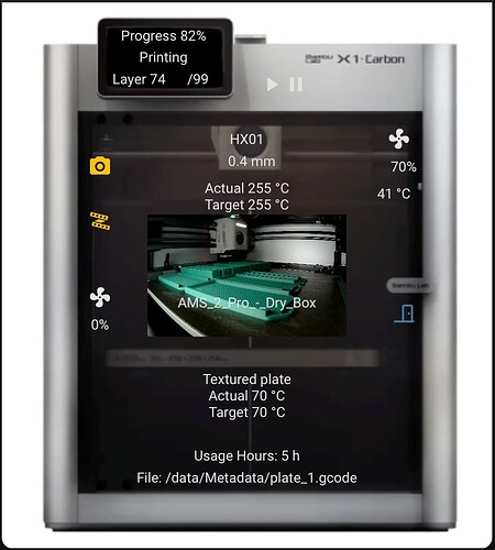

I’m working on a picture element for BamBu Labs AMS 2 Pro. I know there are prebuilt elements which I have tried but I want to create my own. I’ve created one for the Bambu Labs X1 Carbon using a photo and then jus using the HACS intergration to put the elements wanted. But I’m struggling creating a picture element on the AMS 2 Pro because the colour is only presented in Hex where as I want a more descriptive/friendly format. Is there a way I can convert the hex format colour to a predifined name i.e. like a filter, helper, etc? (detailed instructions if possible :slight_smile: as a noob when it comes to things like templating)
Below is the picture element I created for the X1C if anyone is interested. It is quite busy but has all the info I need in a small footprint.

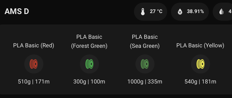

Below is the HACS intergration that I found for an AMS and along the lines of what I’d be looking at for a picture elements card but with extra info like drying times, how much filament left, etc.
