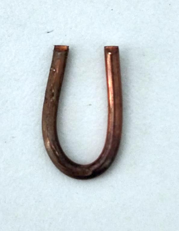

Here it works when short circuiting the RESET and GND contacts for at least 7 seconds. When the display switches to off and on again the reset has completed successfully. Might need a couple of tries because it is a bit tricky to keep a continuous hold on the two contacts.
I made a simple tool out of a 2.5 mm MYW cable to keep the impedance low when executing the short circuit:

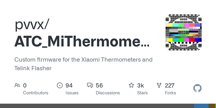

What’s the difference between these two firmwares? I have the latter currently installed from years ago, and it still receiving ota updates via z2m.
