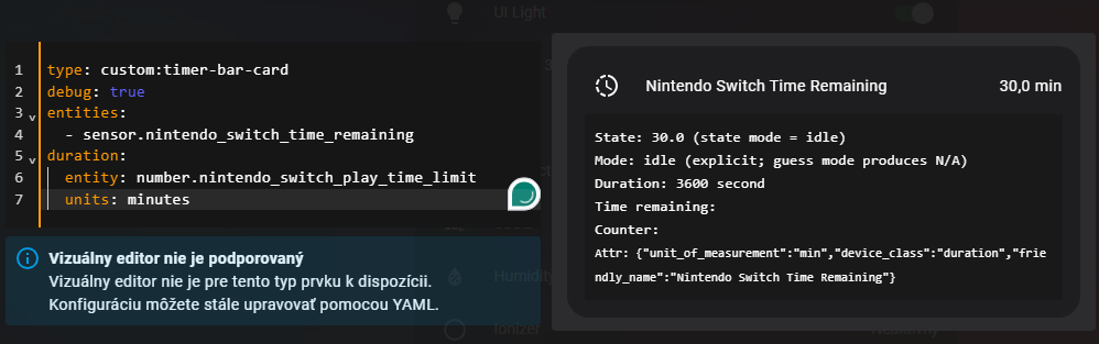

I’m trying to do something similar.
I have the nintendo integration - Nintendo Switch Parental Controls
It produce this:
But I can’t get the bar to display.:
Any suggestions?
