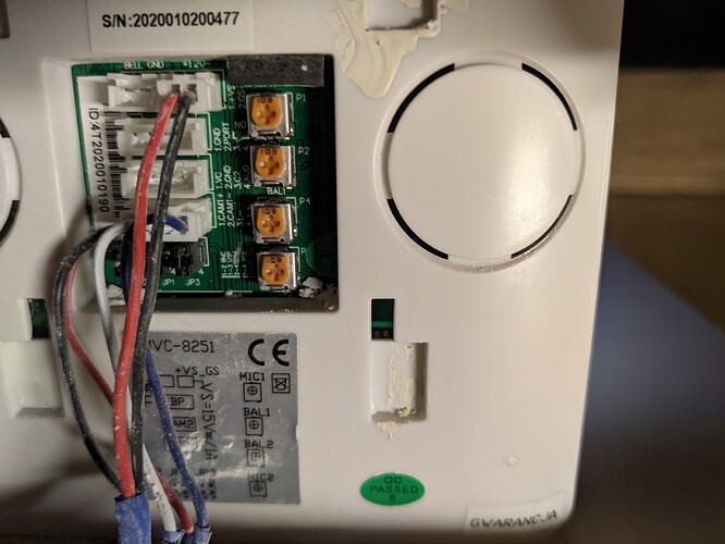

Behind it looks like this, so could add some wires and a raspberry / ESP8266. Would be happy to just tap into the unlock button so dont have to walk 2 sets of stairs to open the door, but getting the video feed would even be greater.
If there’s a standard drop-in, i could replace the whole panel as well if needed. Any help appreciated.
