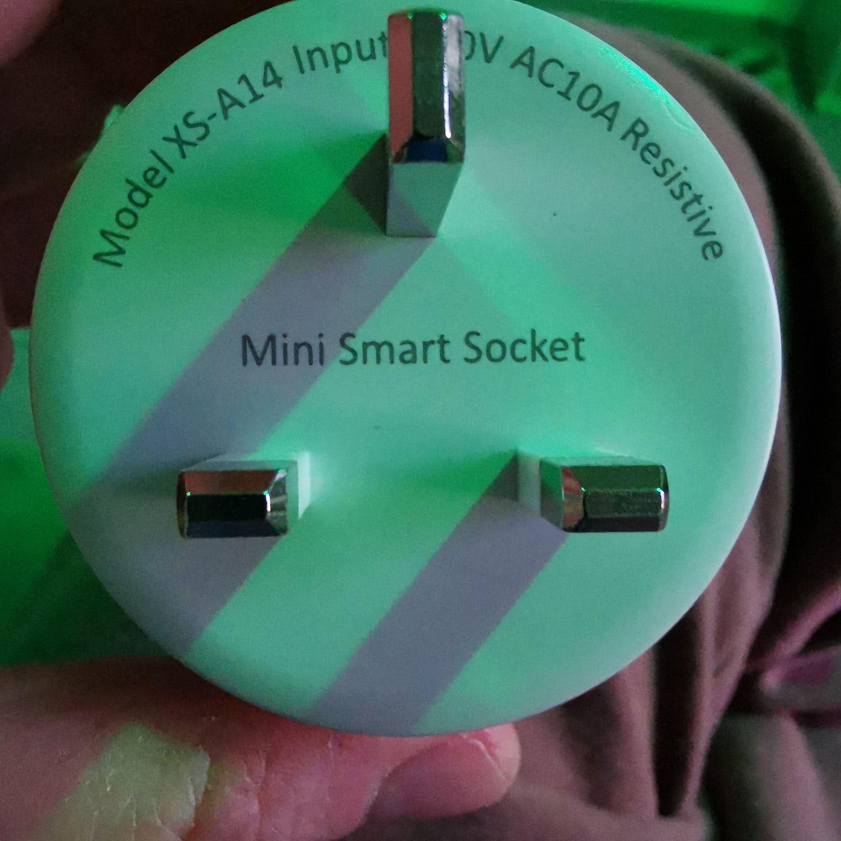

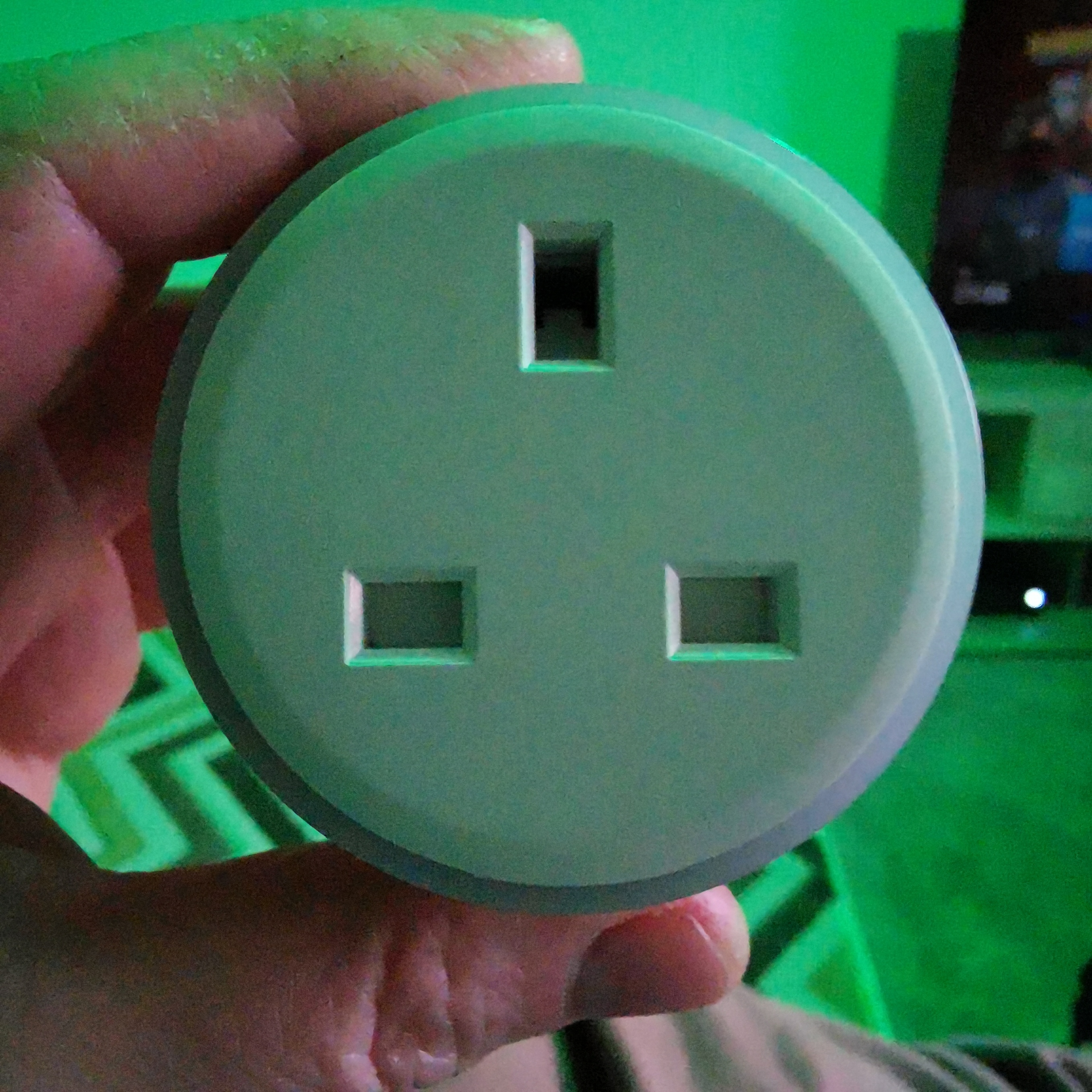

Wonder if any kind soul could help me out. I’ve got some plugs I’ve just hacked with tuya-convert and installed Tasmota on. I now want to convert them to ESPHome (needed to take hass.io offline to do tuya-convert as only have one raspberry pi). Question is it says to work out what sort of plug it is and make a config file from that but I have no idea how to identify it. It looks like this:

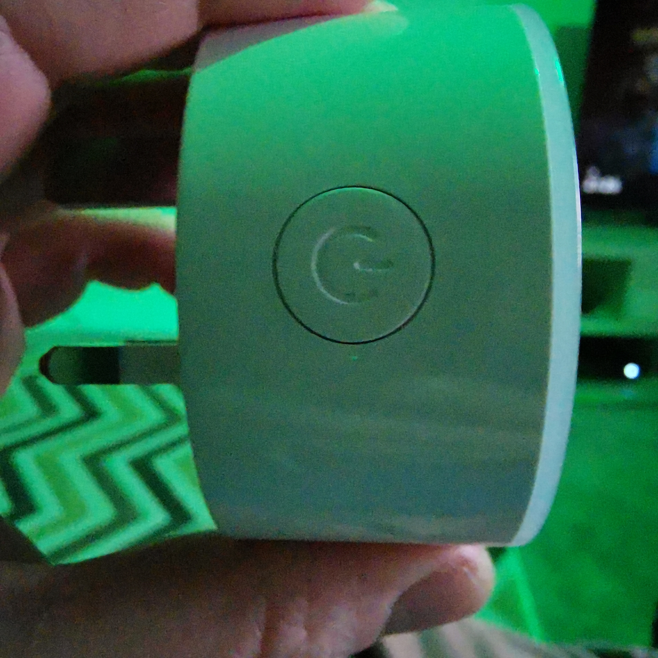

Thanks, nothing on that list seemed right but I did notice the thing was clicking constantly & managed to work out that the Sonoff basic setup had GPIO13 as the LED and worked out the clicking was it turning the relay on & off thinking it was the LED. Altered this and uploaded the ESPHome software thinking I’d risk bricking a switch just to give it a try and it’s worked so managed to add them to HA with working switches. Now gotta work out the LED and Push Button pins but it’s a start.
