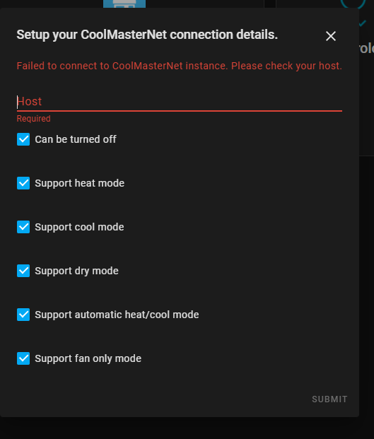

i followed the steps in the mentioned link but un fortunately i cannot integrate cool master net with my HA
Hi @mgamal9152! Have you checked whether CoolMaster Net works through the proprietary Cool Remote app?
I tried the App and it’s Working good
it might be a matter of your network settings. Coolmaster Net uses port 10102 by default. Check if it is blocked on your network.
