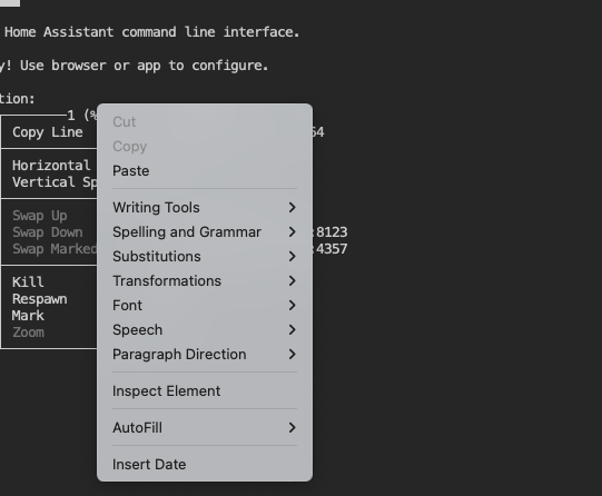

Still broken, when viewing Terminal&SSH from Safari on macOS.
  • Once you hold down the shift key, you are no longer able to sweep out a region with the left button of the mouse until you release the shift key and start over.
  • There is no Insert key on the Mac keyboard.
  • Holding down the right mouse button causes Safari to draw its standard contextual menu, covering the one from Terminal&SSH:
