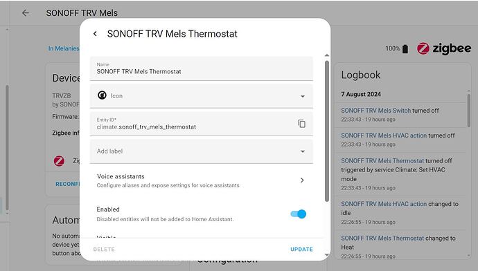

Ok. Then clicking the Settings cog gives:-
So then, that entity is:-
climate.sonoff_trv_mels_thermostat

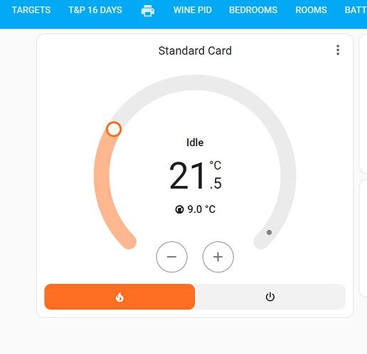

When in the Thermostat Card Configuration edit mode, there is a Features option.
The only option available in this is ‘Climate HVAC modes’. That adds two Mode buttons on the card.
You are correct, pressing the LH button selects Heat mode and the other values pop up.
It was only brief and then returned to the original version with just the measured value.
I suspected the Better Thermostat was interfering with it, so have deleted that and removed the integration.
The standard card is now persistent when heat button is pressed.
Its now using the TRV value as I was hoping for.
