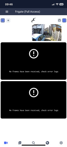

Sorry, the log says it can’t find the coral and frigate isn’t displaying any images
With the coral plugged in and the config set, the metrics won’t load
Coral has nothing to do with the images- only the detection. If you aren’t seeing any images from the camera, you have something else wrong.

Are you seeing images from the cameras? If not, don’t even think of troubleshooting the TPU. You have more basic problems.
