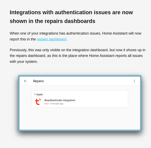

It is weird, because at some point I already saw this feature!
Showed me that my tuya integration is not working (which it is, I know that).
