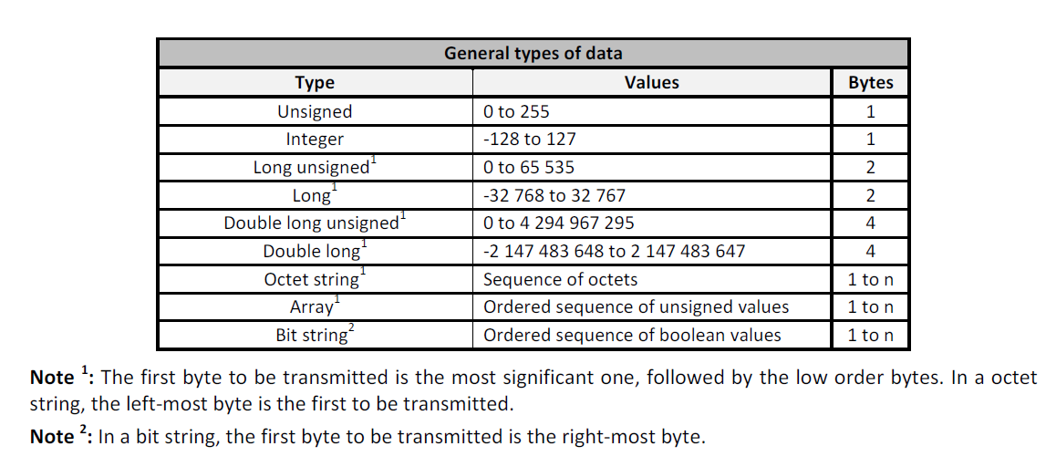

I know that its data_type is a “double long unsigned” (4 bytes), as stated in the device docs:
