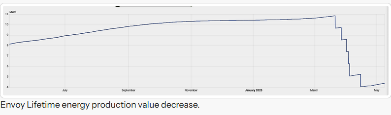

This blueprint will calculate a corrected solar production value for the enphase_envoy integration aggregated envoy or individual inverter solar production value. The envoy firmware calculates inverter production data in a 32 bit value which will reset to zero when reaching 1.193 MWh.
This 1.193 MWh is the (rounded) equivalent of 4294967296 Joule which is the maximum value that can be stored in a 32 bit integer. Due to this limit a single inverter value will drop to zero when this value is reached. Also the aggregated value of all inverters will get a drop of 1.193 MWh at the moment any inverter reaches this value.
So both aggregated and individual inverter data drops with this value. This blueprint will detect these resets and account for it in a corrected value. It will also recognize if these drops are repaired and increase with same amount.

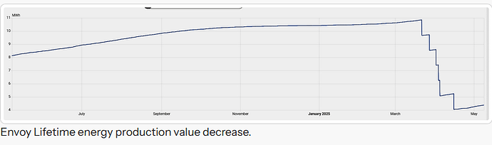

Data as shown in the picture is directly from the Envoy (physical) device. The envoy reports aggregated lifetime solar production by summing reported values from individual inverters.
These inverters sum in production in joules. 32 bit max=4294967296 joule => 4294967296 / 3600 = 1193046 => wH = 1193.046 KwH => 1.193046 MWh.
So when the solar panel has produced 1.193 MWh in it’s life, with current firmware, the value overflows and starts at zero. The Envoy shows this in a sudden drop of value with that amount in the aggregated value.
In my solar installation the aggregated value is at 25.1 MWh for 24 panels and lifetime of 2.5 years. With all individual panels now between 0.9 and 1.14 MWh. Not at overflow point yet, but moving towards it.
Many others reported these steps and experienced this phenomena already.
The drop with this 1.193 amount and some added new production during the 15 min reporting cycle of the Envoy is pretty recognizable. Any (small) drop implies the issue already as production should only increase. Divide the drop by 1.193 MWh and the ceiling is count of panels that dropped in the polling period.
