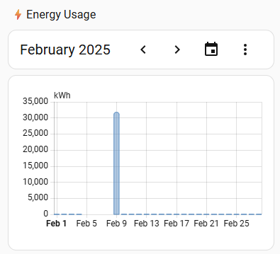

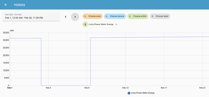

I have had energy monitoring for a few months now and went to review some trends and noticed that there is an error in the energy values - skewing the overall data:

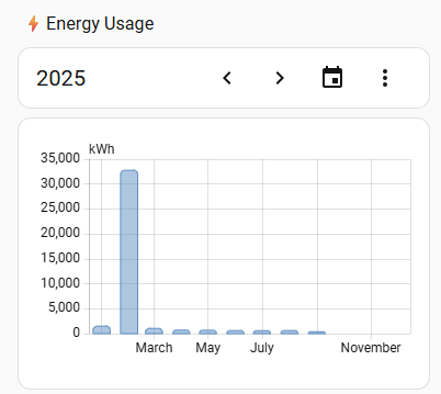

As a result of these "zero"days, when I review the year overall, February is skewed entirely:
