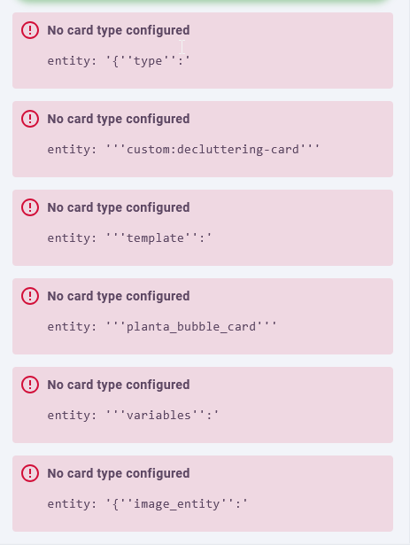

Hey ya’ll,
Necroing a thread here but seems like this info is few and far between. I’m trying to do something along these lines as well but my template isn’t parsing correctly, and I’m not sure why - its very similar to ya’lls above -
type: custom:auto-entities
card:
  type: vertical-stack
card_param: cards
filter:
  template: >-
    {% set STATES = states.image | selectattr('entity_id', 'in',
    integration_entities('planta'))  -%}
    {%- for STATE in STATES -%}
          'type': 'custom:decluttering-card',
          'template': 'planta_bubble_card',
          'variables': {
            'image_entity': STATE.entity_id,
            'watering_entity': null,
            'misting_entity': "sensor." ~ STATE.entity_id.split("image.")[1] ~ "_scheduled_misting",
            'fertilizing-entity': null,
            'repotting_entity': null,
    {%- endfor %}
The null values on the various entities can be ignored, it just leaves a default date when that’s whats passed.
Anyway, the issue isn’t really with the content of the cards - it actually is just reading each part of the array individually instead of reading the array as a single card -
You can see, it fills in the entity list as ‘{’‘type’‘:’, then ‘’‘custom:decluttering-card’‘’, then ‘’‘template’‘’:', etc
  1. There was no need to “necroing» since this should have been asked in the main auto-entities thread. Your question is not related to THIS thread.
  2. Note that “variables” must be a list, in your template it is a dict.
  3. As for the main issue: paste a whole code into Dev tools - Template and you will see what is wrong.
