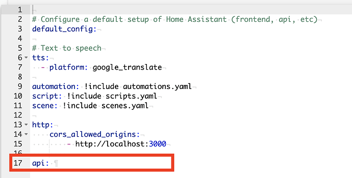

FYI, I’m trying to build a standalone local web app and I ran into a similar issue. So just thought I’d point out something that I didn’t discover until after banging my head against the wall for hours. If you want to make use of the REST API be sure to add this line to your configuration.yaml file:
It’s such an odd way to me to declare “yes, allow access to the api”.
