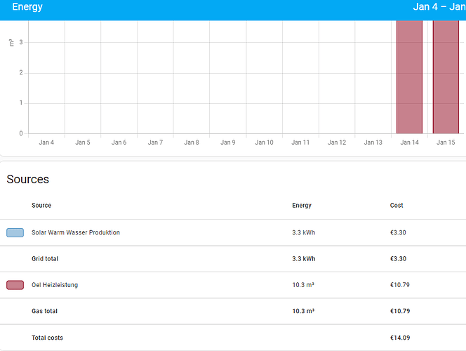

This is what I can see right now:
no helpers anymore, although I cant still see some entities when I look at stats/entities

I am getting values in the energy dashboard, but they do not reflect the costs.

I’m not sure where the “cost” column in the second screenshot is coming from or how it is being calculated. Either it’s built-in to the integration you are using and it doesn’t present you with that information or there is an entity for the price somewhere in your system.
without that data I think you are dead in the water.
