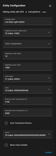

The DPID to set the color is 24. If I recall correctly, it’s in HSV format and you have to multiply the S and V values by 10 so they range from 0-1000. You can set it with the set_dp service or by turning on SUPPORT_COLOR feature in customizations and doing it from the UI.
I also integrated the Costco Feit Led Strip with LocalTuya.
Steps:
npm i @tuyapi/cli -g then tuya-cli wizard )The picture shows my config flow settings.
Thanks to @svkowalski and @vasqued2 for info
Nice job everyone. Following your examples, I got this working for on/off and brightness only. My config flow options are radio buttons, and only show options 20, 21, 22 and 26 for some reason. Any thoughts about why that’s the case? Changing the color, color temperature or built-in scene (which did populate) caused issues with the device not responding.
This was very helpful and works amazing, but I want to warn people you have to go into the smart life app change the color and to the effects dim because sometimes home assistant won’t see the ID number such as 23 or 24 or 25 in the polling. So when you go pick light in configuration of local Tuya you will think you’re crazy because you can’t match be above picture this drove me crazy for a while then I realized . So in my case I learned from my mistake and passing it on, I also have realized if someone could figure out how to do this with their other bulbs you can get their internal effects to work putting it out there.
Just wanted to chime in and say thank you to those who worked on this. Between a YouTube video along with @svkowalski’s directions and @backcountrymountains’s screenshot of the settings - mine works perfectly now. I did discover that if you accidentally fill in a value that’s not needed, like color temperature for example, the only way to clear it is to remove the device and re-add it. But once I did that, I was good to go and the device card functions like any other color changing light.

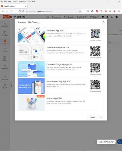

Looking at this again today. I’m curious about how you got this to work. In the doc at https://github.com/codetheweb/tuyapi/blob/6de75590b379dfec6067cbe60ac9cc72756cbf2c/docs/SETUP.md , did you use the method called " Listing Tuya devices from the Tuya Smart or Smart Life apps" or " Linking a Tuya device with Smart Link" . I’m trying the later. The instructions at step 4 don’t match the site at iot.tuya.com .
Which one did you pick ? The 5th requires a subscription.
For the first 4 app types, there is no field called “Channel ID”. Has this been renamed ? And if so, which field is it ? App schema ?
Also, I noticed the trial subscription is only for 1 month , also. Is that needed only for setup, or for continued operation ?
the instructions say to run tuya-cli . That’s not an available command in the HAOS terminal, even though the local tuya integration is installed. Neither is npm , so I can’t run " npm i @tuyapi/cli -g" per the instructions, either. I’m confused as to how I’m supposed to run tuya-cli on my HAOS box.
Are you using HAOS or some other flavor of Home Assistant ?
I’m pretty sure that I chose the former - “Listing Tuya device from the … apps.” I also installed the Tuya integration through HACS and don’t recall doing any command line stuff. I had to set my light strip up in the Tuya smartphone app before I did any of this.
Thanks for your reply ! I finally got it to work. I did have to do a lot of command-line stuff, as described in the doc. I just did it on a different computer, a Raspberry Pi running Ubuntu. I had to switch that Pi to use Wifi instead of Ethernet for tuya-cli to find the devices.
