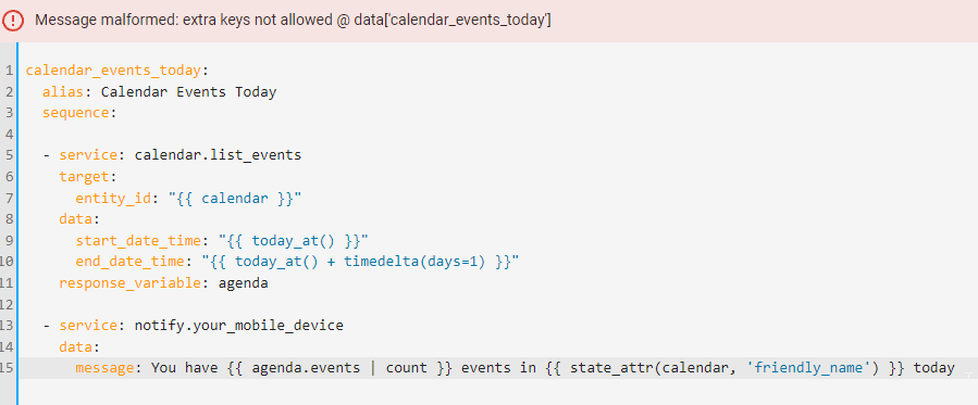

Hello everyone,
Sorry to dig up an old topic, but when I try the code you gave @petro , it throws an error : Message malformed: extra keys not allowed @ data[‘calendar_events_today’]
I must be missing something, but I can’t tell what… any idea ?
You put it in the script section of your configuration.yaml.
