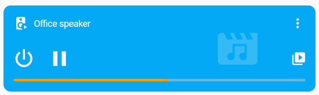

Under what conditions will the dashboard show cover art for an mp3 song? I’m sure that the cover art is embedded, but I’ve tried folder art, too. I’ve tried uploading local media and from DNLA on the Synology, but never can see the cover art. Streaming services show the cover art fine. Is it possible?

I’ve tried the built-in media control card (media_player entity) and the mini-media-player card, both on Lovelace. I now understand that mini-media-player is a card based on the same media_player entity, so I’m guessing that if the built-in media control card doesn’t find the cover art, mini-media-player won’t either.

But the Lovelace media control card does not show it:
When I browse media from the card itself, I see the cover art again, but when I play it, still the blue on the card itself.
