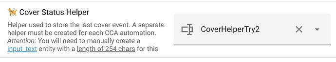

Hello, I’m completely new to CCA and have a few basic questions:
Although I’ve taken almost all of the settings from the blueprint, additionally defined correct and functioning shutter Cover Status Helper, the “Configuration Check” function is returning a ton of errors. For example, the system log shows ‘time_up_early should be earlier than time_up_late’, even though I took over these settings unchanged from the blueprint.
It also reports ‘Cover is missing attribute current_position’, even though my shutter includes this attribute. It also reports ‘Wrong length of the cover status helper’, even though my status helper is defined with “max=255” or “max=254”. It reports many other errors that aren’t even among the features I’ve enabled.
My first basic question is whether the “Configuration Check” function is returning not existing errors, or whether this is actually related to my settings.
I think it will be useful to ask other questions only after the issue of the “Configuration Check” function has been resolved.
Thanks in advance for your feedback.
Best regards
Tom

However, I am getting the same “false error logs” if “Check Configuration” is checked in my CCA.
I did the following:
  • As “CLEAR” in Settings->System->Logs in HA-GUI does not really clear all logs, I truncated config/home-assistant.log to size 0 after having logged into my HA (Raspberry PI4) by ssh and restarted HA by “Restart Home Assistant” in HA-GUI
  • Having manually running my CCA I downloaded the logs from Settings->System->Logs and saw the same “false errors” reported by “Check Configuration”. Please have a look in log file below.
Just a remark: My CCA had been fired by a trigger bevor I run it manually, so you will see it in the log file. I removed from the log file all entries not related to my CCA.

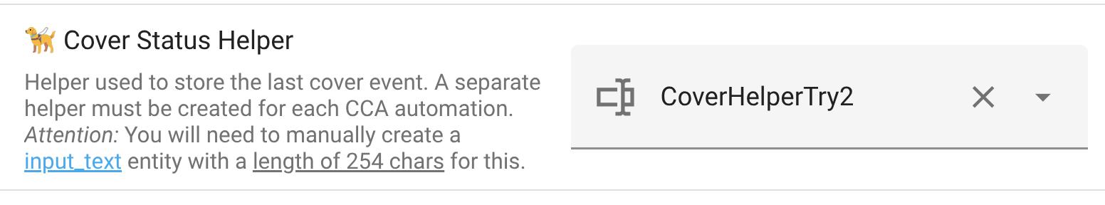

What do you mean with "have … but not flipped the switch”?
I created my Status Helper like described in your CCA Blueprint, i.e. “a input_text entity with a length of 254 chars” within the “Cover Status Helper” dialog and I do not understand what I should have done else - please find an image in the attachment.

My current CCA config:
alias: CCA Test1
description: ""
use_blueprint:
  path: hvorragend/cover_control_automation.yaml
  input:
    blind: cover.plus2pm_roller_cover_0
    cover_status_helper: input_text.coverhelpertry2
    drive_time: 28
    close_position: 16
    auto_options:
      - auto_up_enabled
      - auto_down_enabled
      - auto_shading_enabled
      - auto_sun_enabled
    default_brightness_sensor: sensor.lumi_1_linkquality
    brightness_time_duration: 30
    brightness_up: 1200
    brightness_down: 1000
    check_config: true
    time_control: time_control_disabled
    shading_brightness_sensor: sensor.lumi_1_illuminance
    shading_sun_brightness_start: 100000
    shading_sun_brightness_end: 50000
    shading_temperatur_sensor1: sensor.s1_temperature
    shading_min_temperatur1: 19
    shading_forecast_type: weather_attributes
    shading_azimuth_start: 0
    shading_azimuth_end: 360
    shading_position: 18
    shading_config: []
    shading_elevation_min: 50
    sun_elevation_up: 10
    sun_elevation_down: 15
    sun_time_duration: 1
My Cover Status Helper:
        "id": "coverhelpertry2",
        "name": "CoverHelperTry2",
        "min": 1,
        "max": 255,
        "mode": "text"
cover_status_options: cover_helper_disabled

At last I figured it out - I had to check “Also use an external Cover Status Helper (better)” explicitly … I thought it were an option.
Thank you for explanation to many lines like “shading_azimuth_start should be lower than shading_azimuth_end” or “Sun sensor is missing attribute elevation”, I interpreted them incorrect, sorry for you unnecessary effort.
