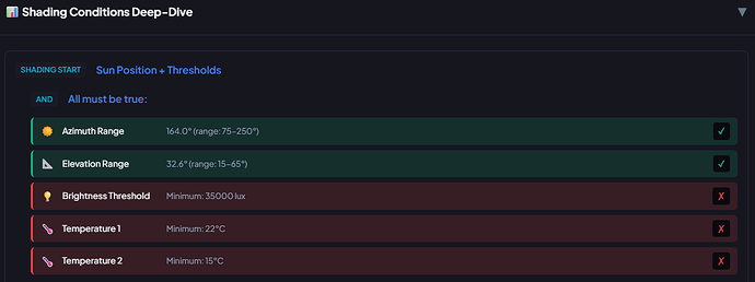

same here, i dont have temp2 and brightness but its still listed as condition in shading conditions deep-dive but automation is working! maybe its a bug in trace analyzer?
