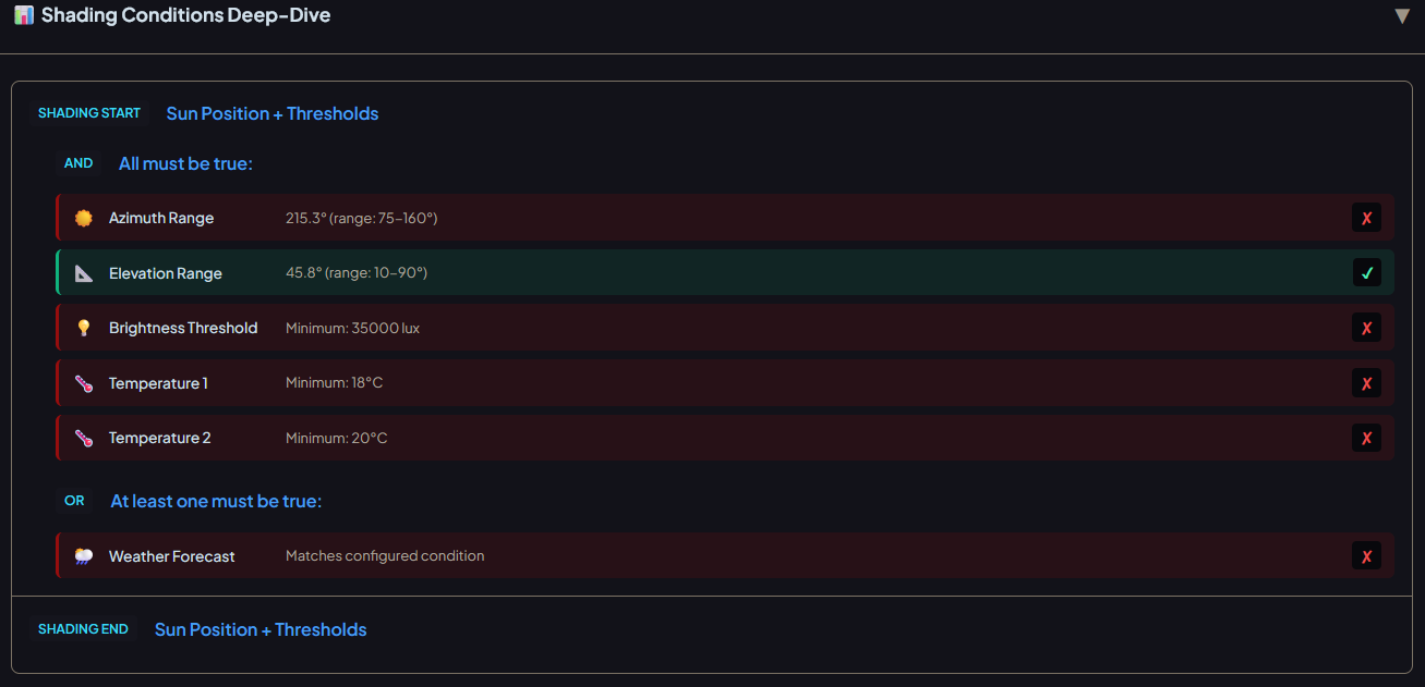

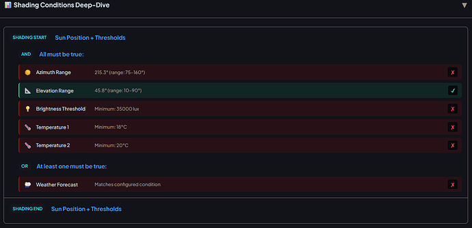

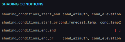

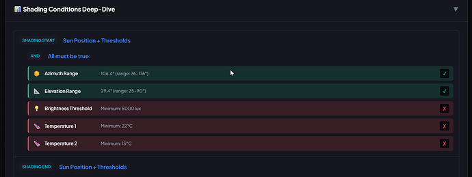

As already mentioned, even sensors which are not configured are shown in the conditions. But there seems to be another bug:
The analyzer shows that the only OR condition is the weather forecast.
Which isnt true, as you can see at the bottom under "shading conditions:
The the information shown on second screenshot matches my config.
btw, nice tool! Makes things a lot easier.

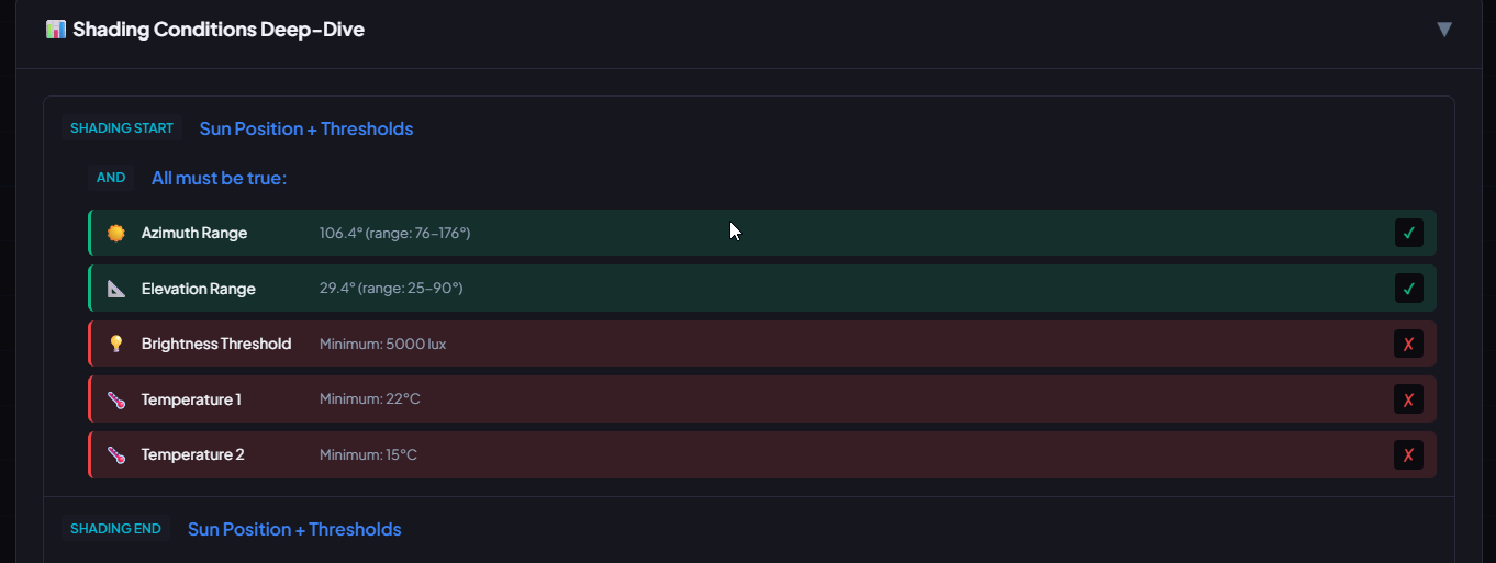

I’m a little confused, even though I’ve been using CCA for quite some time now. :wink:
It’s slowly getting to be that time of year again when we need sun protection, and for some reason, CCA isn’t working quite as well for me right now.
This morning, for example, only one out of four blinds went down, even though I thought they all should have closed.
According to the trace, several criteria weren’t met, but according to the history in HA, all of them were met at that time.
Trace

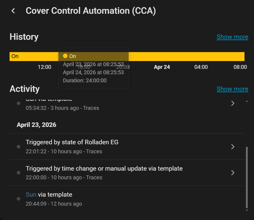

I love the idea of CCA, and i am actively using. But i cant fix my Sun elevation.
What i tried:
  1. Time setup alone works (drives up at 7am, closes at 10 pm)
  2. sun elevation (static with sun.sun) does not work (neither up, nor down)
  3. sun elevation (hybrid/dynamic) does not work (using the provided default template
But i can find a trigger in the history:
my config
alias: Cover Control Automation (CCA)
description: ""
use_blueprint:
  path: hvorragend/cover_control_automation.yaml
  input:
    individual_config: []
    cover_status_options: cover_helper_disabled
    cover_status_helper: input_text.shutter_status_helper
    blind: cover.rolladen_eg
    auto_options:
      - auto_sun_enabled
      - auto_up_enabled
      - auto_down_enabled
    shading_position: 69
    time_up_early: "07:00:00"
    time_down_early: "22:00:00"
    time_down_early_non_workday: "22:00:00"
    time_down_late: "22:00:00"
    time_down_late_non_workday: "22:00:00"
    sun_elevation_up: -6.6
    sun_elevation_down: -2
    time_up_late: "07:00:00"
    time_up_late_non_workday: "07:00:00"
    shading_forecast_sensor: weather.forecast_home
    shading_forecast_type: daily
    shading_forecast_temp: 20
    shading_temperatur_sensor1: sensor.shellyht_outdoor_temperature
    shading_waitingtime_start: 180
    shading_waitingtime_end: 180
    check_config: true
    workday_sensor: binary_sensor.workday_sensor
    workday_sensor_tomorrow: binary_sensor.workday_sensor
    default_sun_sensor: sun.sun
    sun_elevation_mode: hybrid
    sun_elevation_up_sensor: sensor.sun_elevation_up_dynamic
    sun_elevation_down_sensor: sensor.sun_elevation_down_dynamic
Edit: I am fairly new to home assistant… i just found the trace of the sun elevation in the morning, but i cant quite understand the problem:

hi,
the problem is, that you have fixed values for up and down.
You need a time range (early and late)!
for example:
for upset the time between 7 (early) and 8 (late) and down between 20 and 22
Now there are 2 time slots! During this timeslots, if the sun elevation will be trigger, the cover will open or close!
In your case the sun parameter was trigger at 20:44 but you have no β€œtimeslot”…try to change the early close to 20 and you will see, the cover will close when the sun elevation is reached!

    shading_conditions_end_or:
      - cond_azimuth
      - cond_elevation
    shading_elevation_max: 89
    shading_end_immediate_by_sun_position: true
