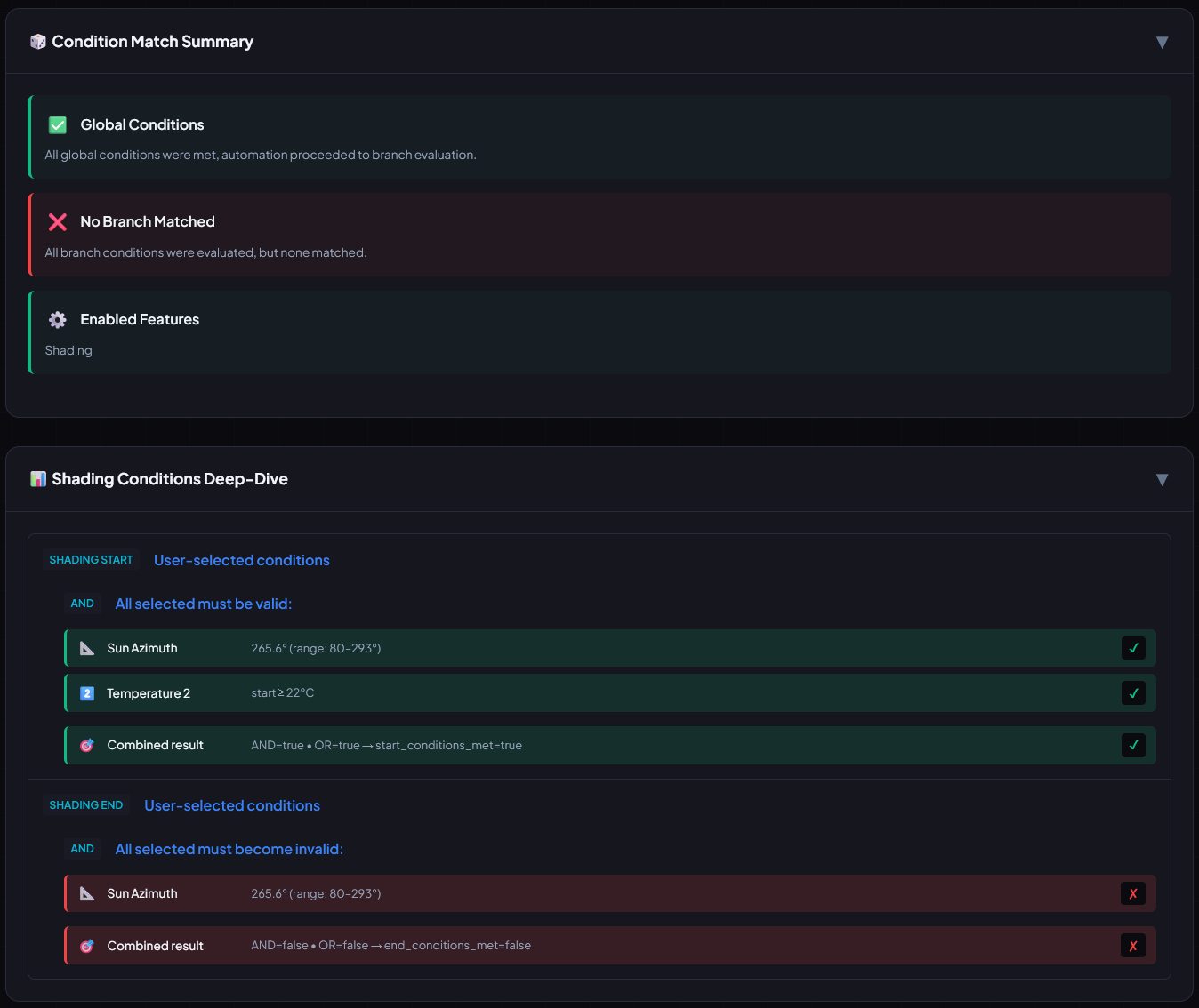

Hi there, I have a question to make sure I understand:
If all the AND conditions for shading are met, then the corresponding branch should be activated, right?
The CCA Trace Analyzer shows different (from my point of view)
Hi yokads,
Good question! The Trace Analyzer's "Shading Conditions Deep-Dive" only shows the user-configured conditions (azimuth, temperature, etc.) — but those are just one piece of the puzzle. The shading branch has several additional internal conditions that must also be true for it to match.
The most common reasons for "No Branch Matched" despite valid shading conditions:
  1. Wrong trigger — The shading branch only responds to specific trigger IDs (t_shading_start_*, t_open_1). If a different trigger fired (e.g. time, contact sensor, resident sensor), the shading branch won't match — that's by design.
  2. Time window — If time control is enabled, shading can only start within the configured time window (is_shading_allowed_window).
  3. Already shaded — If the cover is already in the shading position, the branch may be skipped.
  4. Daily limit — If "prevent multiple shading" is enabled and shading already ran today.
  5. Manual override — If you manually moved the cover and "ignore shading after manual" is configured.
  6. Force active — If a force function (force open/close/ventilate) is currently active.
To help diagnose your specific case, could you share:
  • The full HA automation trace (Settings → Automations → your CCA → Traces) — this shows which trigger fired and which conditions failed
  • The current helper JSON (the input_text entity state)
With that info we can pinpoint exactly which condition blocked the branch.

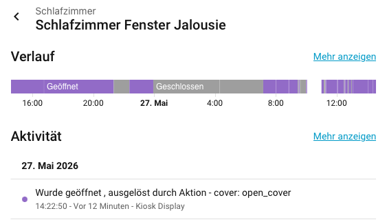

I can't figure out why the shutter is closed. I set it to open at 7:30 a.m. (which works fine), and the shading control kicks in early in the afternoon (south-facing), but at 10:00 a.m., after I close the window, the shutter closes.
I've been trying to figure this out for three days now (but haven't had much luck...)
The configuration, trace, and helper files are here

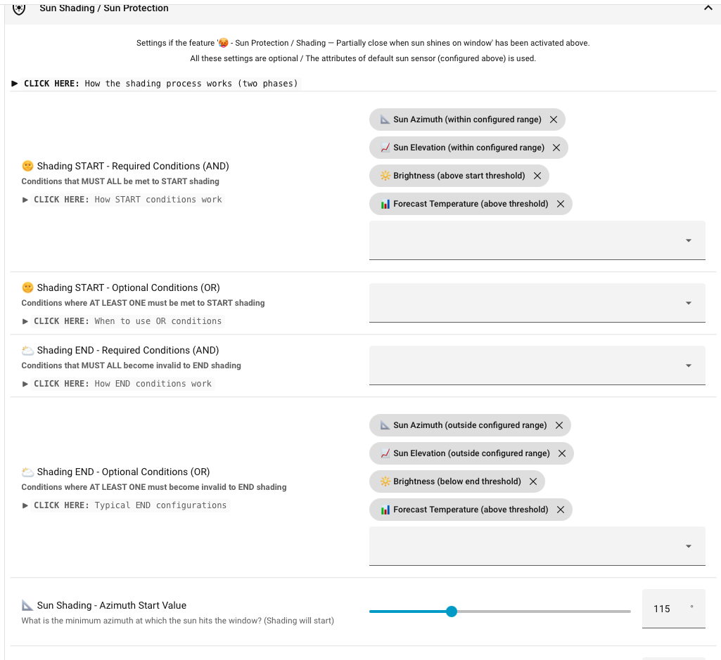

@Herr.Vorragend one more thing I just saw, the Forecast option is also named "above threshold" for the Shading End function and I am not sure if its just wrong naming or if the option itself is wrong to be used in Shading End Function because it would check above threshold and not below threshold as I would expect it to do.
Good catch — it's just a wrong label, not a logic bug.
The underlying logic is correct: shading ends when the forecast temperature
drops below your threshold (forecast < threshold − hysteresis), exactly as
you'd expect. Only the dropdown label was wrong — it still said "above threshold",
copied from the START side instead of being inverted like the other END conditions
(azimuth → outside, brightness → below end, etc.).
Fixed the END labels:
  • 📊 Forecast Temperature → now "below threshold"
  • 🌦️ Forecast Weather Conditions → now "no longer matching configured conditions"
    (same copy/paste issue — the END logic checks not matching)
Pure label change, no behavior impact. Your existing config keeps working as before.
The text has just been corrected.
