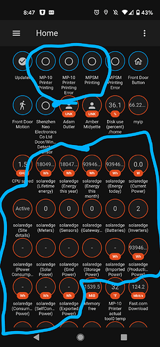

So I was checking out the related integration code and I can understand it. But I can’t find any documentation about how to create a device. Can you point me at something I can use to group these 20 entities into a device which can be assigned to a room? Solar edge is just a steaming pile of crap on my lovelace and I need to do something about organizing it. I figure I could convert it into a custom integration but I can’t find documentation on how devices work.

I have control of several lovelace dashboards. I like the overview dash, but there’s no option for guided control over the overview. I’d like to maintain a 100% dashboard.
