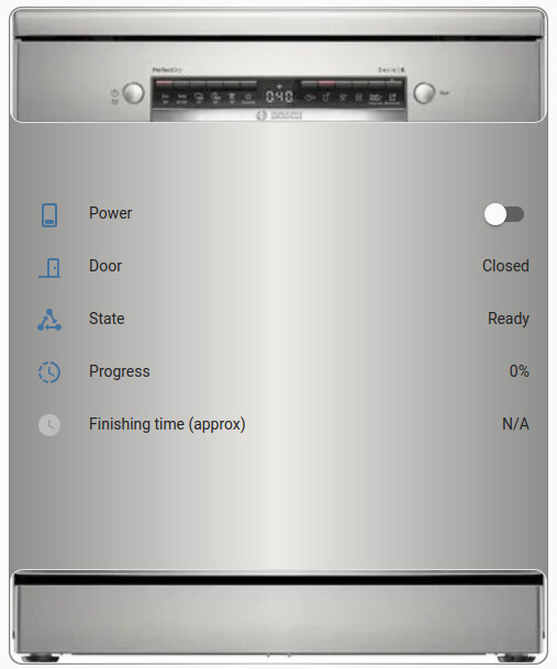

My new dishwasher is connectable via Home Connect so I thought I’d have a go at creating a card for it. I haven’t done anything much with HomeAssistant for some time, and have hardly any experience with cards at all. I managed to cobble together something that works, but I could do with some advice on improving it. Code so far is:
type: custom:vertical-stack-in-card
cards:
  - type: picture
    image: /local/images/dishwasher-top.jpg
    tap_action:
      action: none
    hold_action:
      action: none
  - type: entities
    card_mod:
      style: |
        ha-card {
          background-color: transparent;
          box-shadow: none;
          --ha-card-border-width: 0px;
    entities:
      - entity: none
        type: custom:template-entity-row
      - entity: switch.dishwasher_power
      - entity: binary_sensor.dishwasher_door
      - entity: sensor.dishwasher_operation_state
      - entity: sensor.dishwasher_program_progress
        state: |
          {{ states(
            "sensor.dishwasher_program_progress")
      - entity: sensor.dishwasher_remaining_program_time
        name: Finishing time (approx)
        state: |
          {% if states("sensor.dishwasher_remaining_program_time")
           != "unavailable" %}
            {{ as_timestamp(states(
            "sensor.dishwasher_remaining_program_time"))
            | timestamp_custom("%H:%M") }}
          {%else%} N/A {%endif%}
      - entity: none
      - entity: none
  - type: picture
    image: /local/images/dishwasher-base.jpg
    tap_action:
      action: none
    hold_action:
      action: none
card_mod:
  style: |
    ha-card {
      background: #aaaba9;
      background-image: -webkit-linear-gradient(
        right, #8f8f8d, #edebe8, #8f8f8d);
      box-shadow: none;
… and it renders like this:
My main question is about how best to handle the cleaning programmes. They are are exposed as a series of switches e.g. switch.dishwasher_program_eco50, switch.dishwasher_program_intensiv70 etc. and I don’t want to show each of those as separate controls on the card. Is it possible to create some sort of drop-down list containing each available programme name so that one can be selected, and then have a button that willl activate the chosen switch when pressed?
Secondly, I’m using some blank entities simply as space-fillers. Is there a better way to do that?
Any other tips, suggestions or comments welcome.

yeah, you could add some padding to the top of the .card-content element, and for the base image, why nog use the footer option of the entities card?
It would make the spacing a bit more robust and adaptive to the sceensize. Otoh, if this works for you, why not ? (I would Not use a custom card for the empty spot though, why not an empty core entity?
  - type: divider
    style:
      background: transparent
      height: 50px

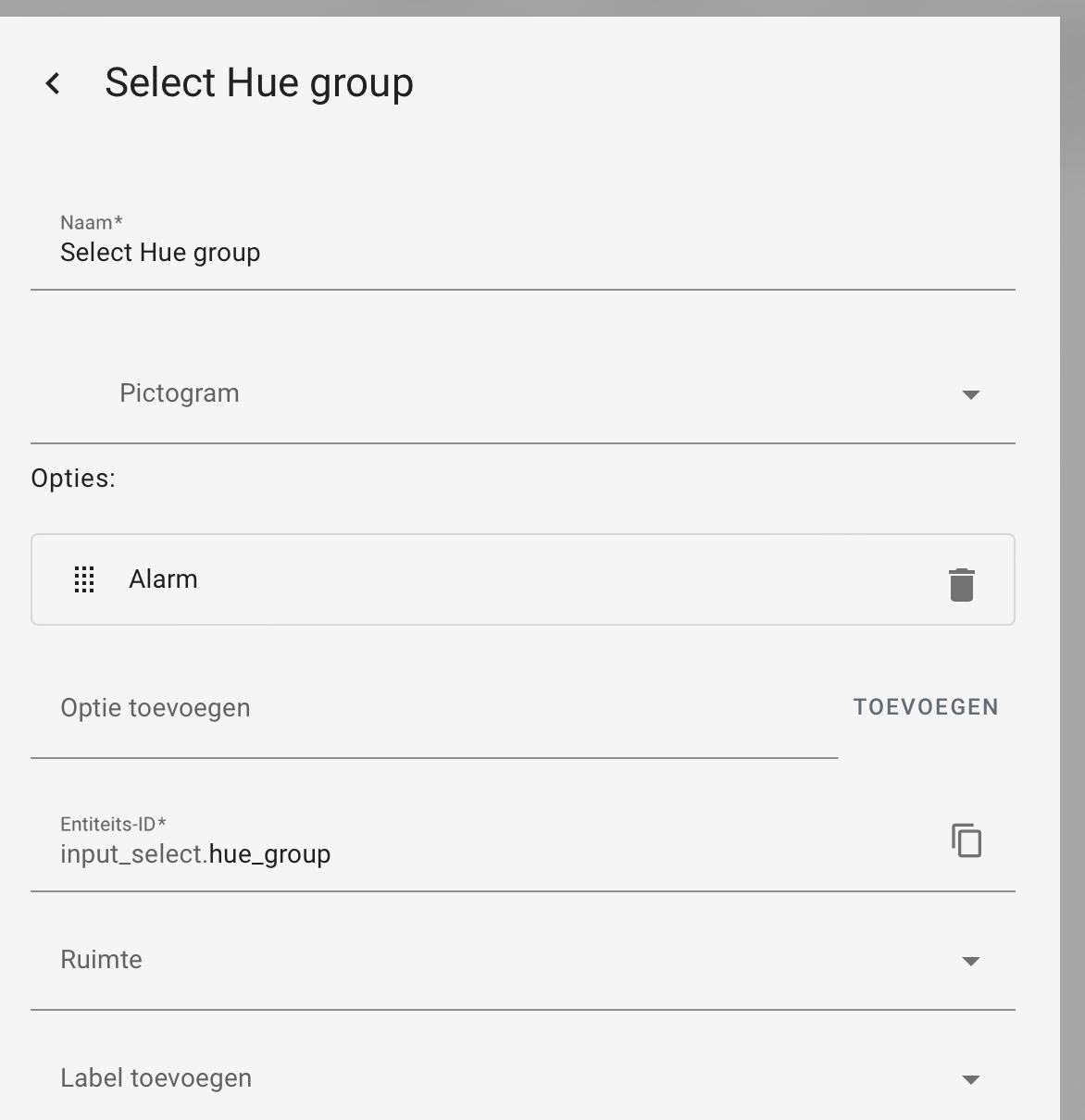

that is totally possible, see what I do here:
automation:
  - id: auto_populate_hue_group_input_select
    mode: restart
    trigger:
      platform: event
      event_type: delayed_homeassistant_start
    action:
      service: input_select.set_options
        entity_id: input_select.hue_group
        options: >
          {{expand(label_entities('hue_groep'))|map(attribute='name')|sort|list}}
you have to create the input_select in the helpers menu, and give it 1 option to start-up…

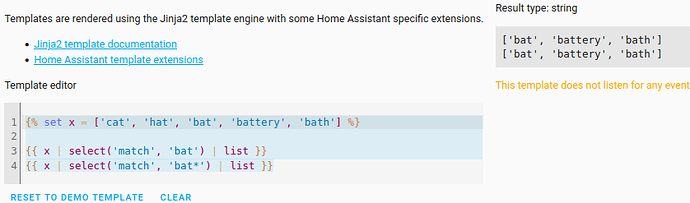

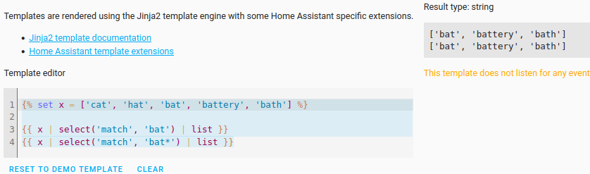

NOTE
For the match filter’s pattern, a final asterisk is implied. The following example demonstrates the result is the same with/without a terminating asterisk.
