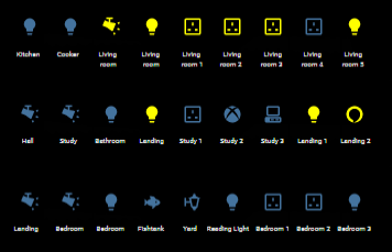

There is a custom card in HACS called Vertical Stack In Card. It does the same as a vertical stack, but with no card borders, so the whole thing looks like one card.
Alternatively, you might try making the card backgrounds transparent, so when they have nothing to display they disappear altogether. This is easiest to do in the theme: card-background-color: rgba(0,0,0,0). It will affect all your dashboards, though, so other things may not look right.
nobackground
This is what i’m looking for, tnx!! :+1::ok_hand:
