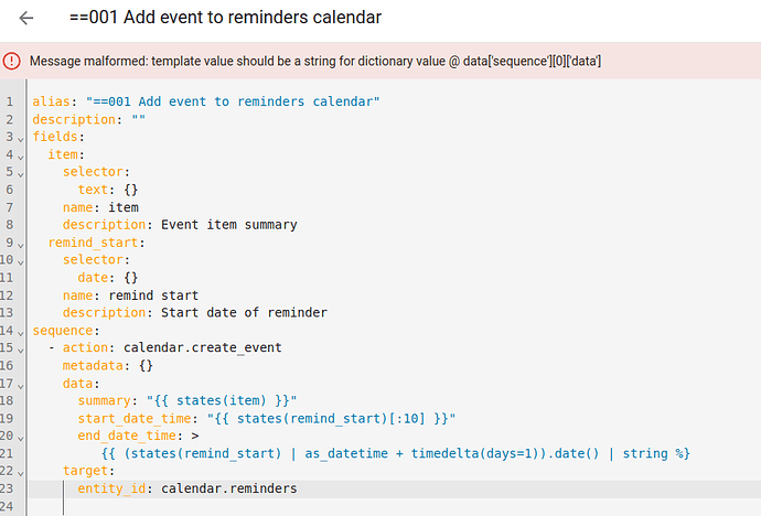

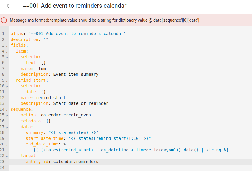

@123 Thanks for the prompt reply.
When I paste that into the script, it will not let me save it, giving the error shown below:
Similar to some of the previous errors I have seen. I think I understand your logic on line 21 to convert the variable to and then back from date type.
My primitive understanding suggests an issue with the first item of data under sequence, but I may well be wrong. (I tried without states and got the same) (I guess it could also be something missing elsewhere that makes the first item wrong - hence my maze-like journey so far.)
Does the [:10] slice the front/back from the string to give a date (without time)? The helper was set up to gather just a date so do I need this?
I tried adding a dummy 3rd field/parameter called remind_end, in case it was expecting it, but it made no difference.
I made a small mistake in the template for the end_date_time option.
While converting from your template, I forgot to change the final %} to }} so that’s what caused the error message.
I fixed my example posted above.

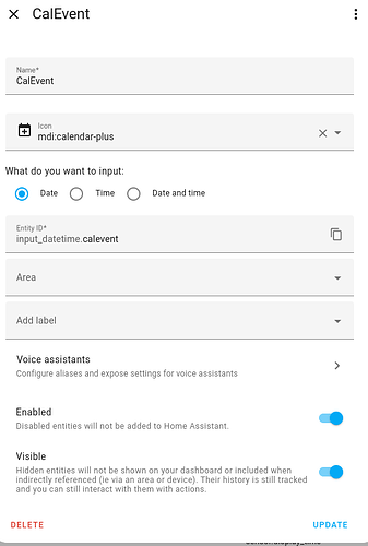

Yes - the helper is set to input date (only)
