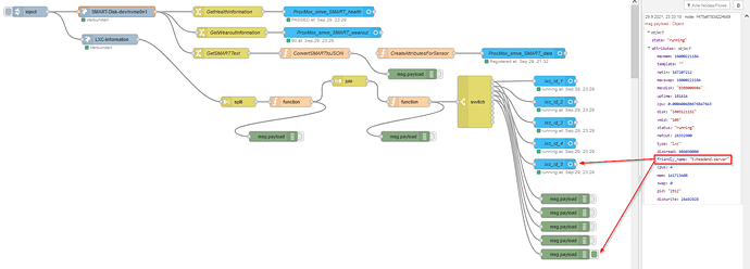

it seems that the HomeAssistant Contribution for NodeRed does have one major issue…
Finally, I was able to replace the attribute “name” in my messages with “friendly_name” - which I thought would be used by HA as attribute, like it is for all other sensors, like this for example.
grafik
So, this is my RodeNed Flow…
I am using your method to provide the values to each sensor, but before this, I am converting the content to a string, do a replacement of the “name” - and convert it back into a JSON object.
Finally, you can see, the “fiendly_name” attribute in the output.
Unfortunately,
The Integration does have one BIG issue:
Here, you can set the “name” of the sensor, which will be used as Friendly_Name in HA.
This is optional - and can be blank.
Unfortunately, if I try this method, the Sensor will be registered in HA but does not use the attribute friendly_name - instead, this attribute will be overwritten… :frowning:
The next thing I’ve tried was to assign the “friendly_name” additionally as attribute to the sensor like this:
grafik
So - the main issue seems to be, that the friendly name will be set to a random value when it is not set - and the attribute will not be taken.
Another issue is, that you can’t select msg.payload… to define the name of the sensor in HA…
Maybe, I can fix this within the homeassistant-node-red-contribution? :thinking:

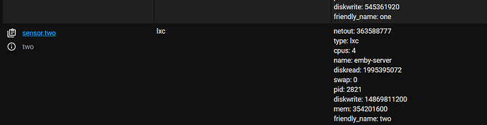

How about setting the attribute friendly name in the function node?
Have you tried that?
I just tried in a debug node and it’s set at least.
I just added one line to add the friendly_name.
But you need some way to make that dynamic I guess or all will have the same name.
var arr = [];
msg.payload.forEach(function (value,index) {
    msg.index = index;
    msg.payload ={"state": value.type,
        "attributes":value
    msg.payload.attributes.friendly_name = "test";
    node.send(msg);
The way you set your friendly name in the image is probably incorrect.
You try to set friendly name to something that does not exist. You point it to the attributes of the message, but I can’t see a friendly name key there.
Hi, thanks for the help.
As far as I got from the Node-Red Integration Developers, the Attribute friendly_name cannot be set dynamically.
The problem is, that the sensor needs to be registered when the flow is deployed.
In this case, the friendly_name will also be set.
Therefore, it cannot be set during the runtime when the flow will be executed.
It seems, that there is some more work required to update the attribute, but I think - I’ve found another way to workaround.
