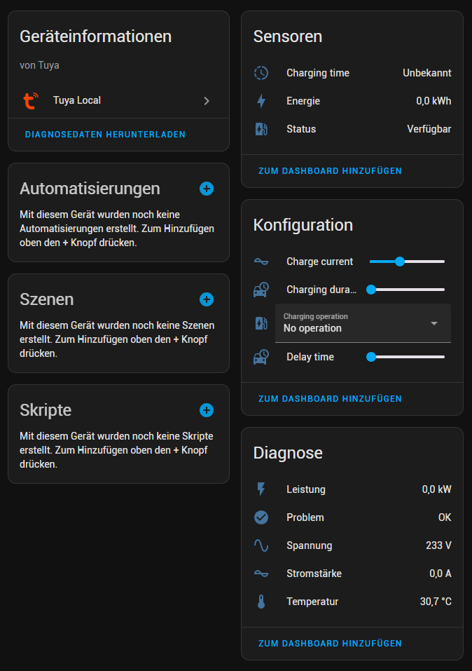

I just bought a tuya compaticle wallbox charger and of course the normal tuya integration just shows “unsupported”.
Instead use GitHub - make-all/tuya-local: Local support for Tuya devices in Home Assistant
I installed it via HACS, added the User Code (That you can get from the app as explained here: Tuya - Home Assistant) and then it instantly asked me if I wanted to add the wallbox I had added to the app prior.
Now I have a new device:
Haven’t tested it on my car yet, but if I change the “Charge current” setting then it instantly changes on the device and vice versa.
Edit: Tested it on my Kia Cee’d Hybrid: While charging you can adjust the Charge current and the car will switch to that current immediately.
I do have to say that you can set charge currents that aren’t supported. I started with 6A and the charger just said “Connecting”. Once I changed it to 8A, which the normal charging brick for the car can do too, and plugged the charger into the car the car started charging. I also only testes 8A, 10A and 12A, since that is what the normal charging brick can do.
And to top it all off I’ve only tested this with a single phase. The charger supports 3 phases, but we need to get a 3 phase CEE outlet for that first.
