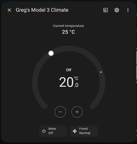

I have created a picture-elements card for my Tesla from a template written by @alexbeatle (thank you!). But I wanted to know if I can get the popup from the climate entity card which looks like this when the entity is clicked/tapped.
I want to be able to click/tap the climate icon in the picture-elements card and have the above popup so that I can control the temperature etc.

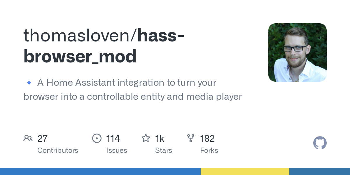

I use browser mod for pop-ups throughout my dashboard.
I also use better thermostat throughout my dashboard, just because I like it over the stock thermostat.
But surely the stock or any other one can be used similarly.
Since I have those two, it was easy to setup…

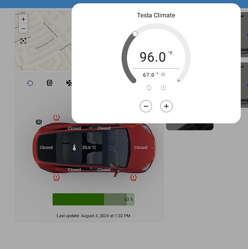

      - type: conditional
        conditions:
          - entity: climate.<car_name>_hvac_climate_system
            state: 'off'
        elements:
          - type: icon
            icon: mdi:fan-off
            hold_action: none
            double_tap_action: none
            tap_action:
              action: call-service
              service: browser_mod.popup
                content:
                  type: custom:better-thermostat-ui-card
                  disable_window: true
                  disable_summer: true
                  disable_eco: true
                  set_current_as_main: true
                  disable_menu: true
                  disable_off: false
                  disable_battery_warning: false
                  disable_buttons: false
                  layout:
                    mode:
                      headings: true
                      icons: true
                      names: true
            style:
              top: 6.5%
              left: 36.6%
              color: black
      - type: conditional
        conditions:
            state: heat_cool
        elements:
          - type: icon
            icon: mdi:air-conditioner
            hold_action: none
            tap_action:
                content:
                  disable_eco: true
                  disable_menu: true
                  disable_off: false
                  layout:
                    mode:
                      headings: true
                      icons: true
                      names: true
            style:
              top: 6.5%
              left: 36.6%
              color: '#039be5'
Still strying to figure out how to use “climate” with Celsius, while I have US units globally.
Thanks so much. This is exactly what I am after. Great work on the card, cheers!
