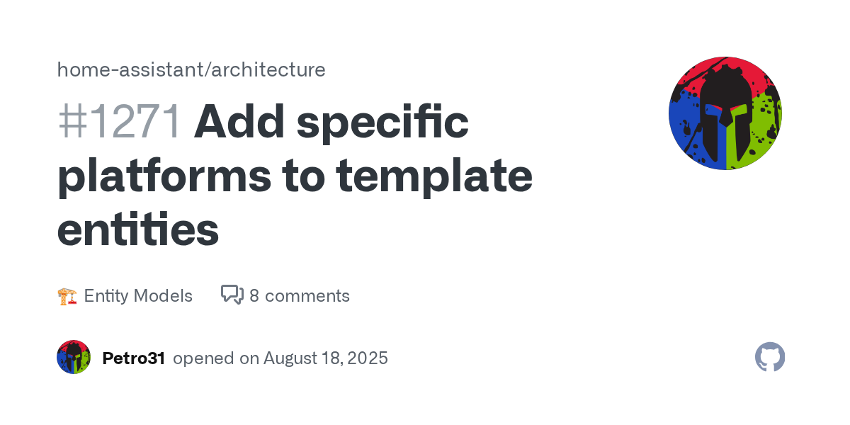

I noticed my last comment is still getting traction, the likelyhood of a remote being added to templates is very low. The core team is attempting to completely remove that platform in favor of button entities. I suggest everyone transition to those instead of using a remote entity. If you create the button via the UI, you can attach the buttons to existing devices which would act like a remote.
You can track what the current core team is allowing me to add. I’ve been working with them behind the scenes to adjust the table in the following discussion.
You’ll notice remote has a red x
