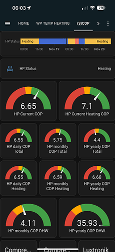

Definitely got it! :slight_smile:
The trick is to use utility meter. Those auto reset daily, monthly, whatever… and then do that for energy used and energy “created”. You can create an automation to switch the current “tariff” of the utility meter to the heat pump status. (So I have tariffs for heating, domestic hot water, cooling and idle).
Hope this helps.
(The yearly cop DHW is an error ofcourse… it’s fixed, but the data won’t restart until January first and haven’t been bothered with it really).
