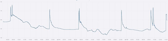

I don’t have a second sensor. Below you see the history of the sensor in my bathroom:
As you can see sometimes its around 58, 50, less then that, sometimes higher
The sensor is updating when there is a difference of 0,5
