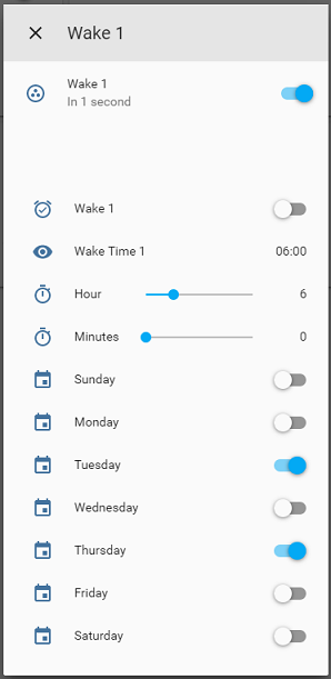

So, because my job isn’t a 9-5 M-F one, I’ve created a variation on this alarm clock that runs my “wake up” script and let’s me choose specific days for it to run - for instance, I may have an 8am shift on Monday and Wednesday that I need it for.
(I haven’t read the whole 3 years of posts on this topic, so I hope I’m not duplicating anything here, but if anyone else needs something similar here it is.)
I’ve added input_booleans for each day of the week, and a sensor that will list which days are “on” in the “minimized” card.

I have a “wake_1” group defined, so I can get this:
And when I put it on an entity card with the sensors I get this, for an at-a-glance summary of what alarms I have set (I have multiple copies for other days with different wake up times):
I hope this helps anyone who needs it!
