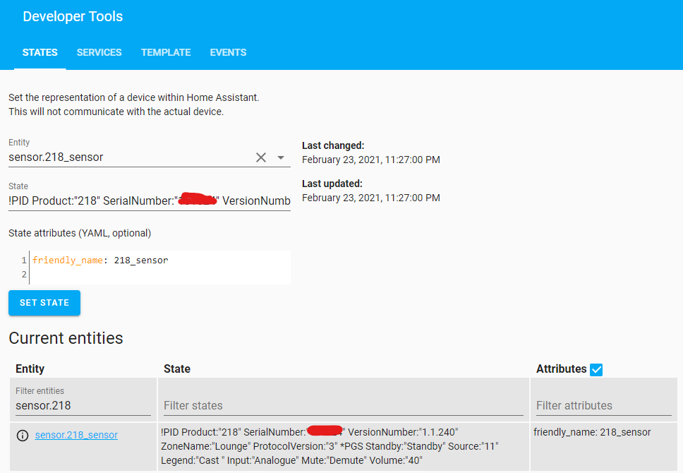

I am really struggling with Templating. All documentation I have read describes extracting value from the attributes of a sensor. the problem is the feedback from my sensor is placed into the state.
