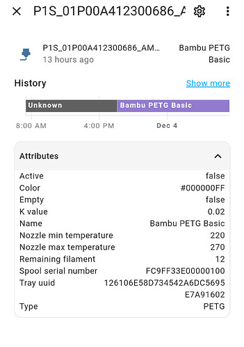

I have a 3D printer which reports a serial number, color, material, and filament remaining for the currently loaded spool of filament. I would like to use this data to build a table of all my spools and their last-seen data. I’m not quite sure how to approach this, or if it’s even possible.
Here’s what the spool sensor reports:
