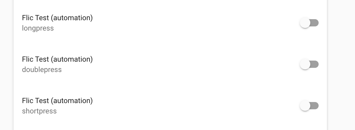

Interestingly, because I’ve not seen this before and it clearly relates to his issue, I created three local webhooks this morning to test out the new Flic 2 hub and buttons that arrived.
I had this problem, which led me here. I was in the process of creating a new HA image and wanted to reuse some webhooks I had set up in the old image so I didn’t have to change them in the app that used them. I went through the creation process and then replaced the generated webhook with the one from the old image. It accepted it and then turned off the webhook. Turning it on gave the error message: “Unexpected error: Hook is already enabled for the cloud.”. Went back to the automation and changed the web hook name to another one I needed to set up. The old one disappeared from the Home Automation Cloud webhooks listing. Lesson learned: don’t change the generated webhook.
Update
As I added additional webhooks in the same manner the Home Automation cloud would switch from showing them and the toggle switch in a random manner or least in no pattern I could discern. When I tested them, they all worked. I suspect the issue is my with synchronization with the nabucasa cloud. I never did test the reused hook so maybe it was good too.
