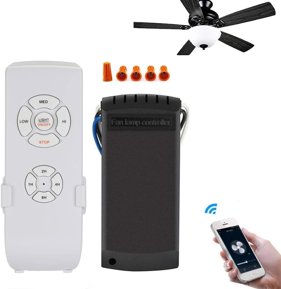

My fans used to have a control module with remote but no wifi capability, so I replaced them with these:
which can be controlled in Home Assistant through the TUYA integration.
