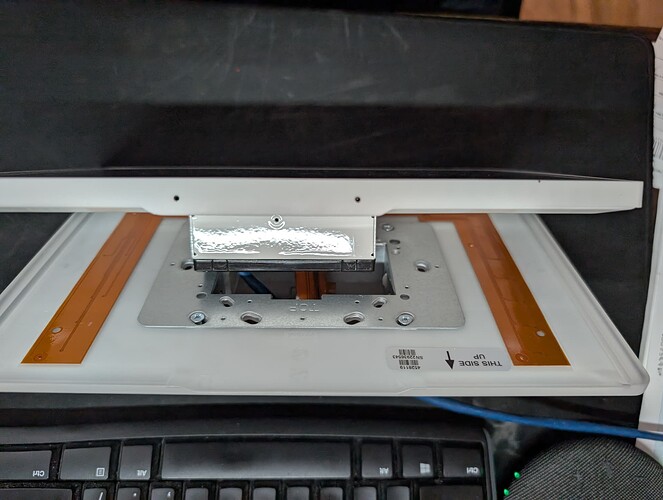

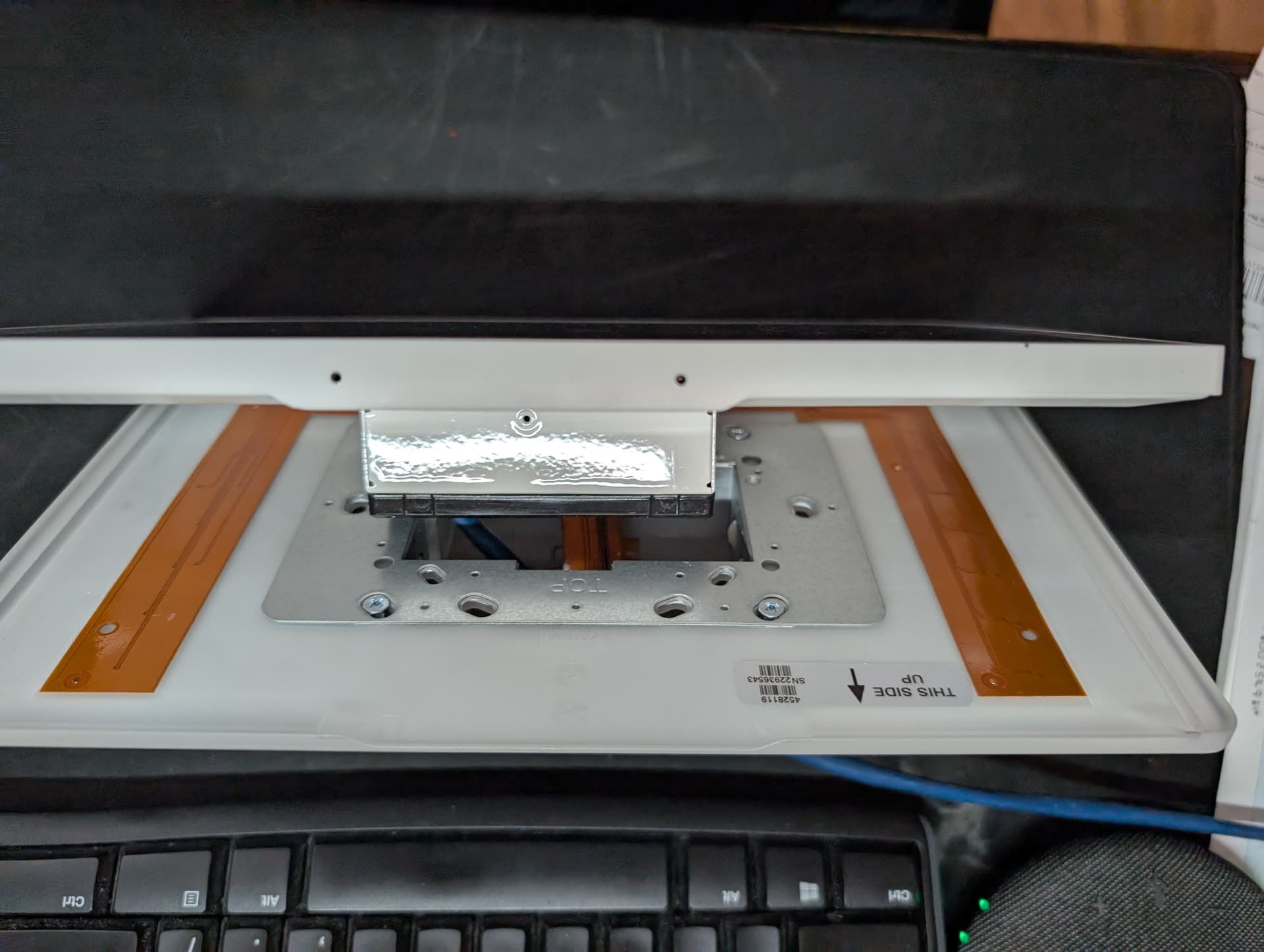

Beat me to it, I was just about to post this here for the group as I purchased and the item finally arrived. Bought 2 and they arrived and I wasn’t sure what I received … lol …didn’t realize it had the light bar mounted too!
I can’t figure out how to pull that angled mount on the back off tho.
It took me a minute to figure it out, you have to put your fingers between the screen and light bar and wiggle them apart, rock back and forth, top and bottom all the way around. It’s only friction fit in the mount. It’s going to feel like you’re going to break the light bar but keep working it and it’ll come apart.

Oh thanks for that! I dig up pdf for the multi surface mount and used a plastic putty nice to reach in and pry. But you are right, it did feel like I was gonna break something

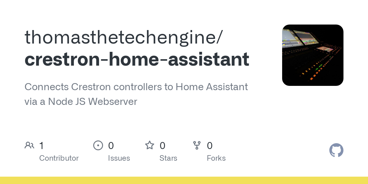

If anyone is interested, heres the project I made that allows crestron to HA communication.
A better option is to ditch the controller code altogether, and use a server with connects to the panel itself.
Here is an example:
What this does is that it responds to commands directly from the touchpanels.
So all you need is to build the project in vt pro, and intercept the joins…
