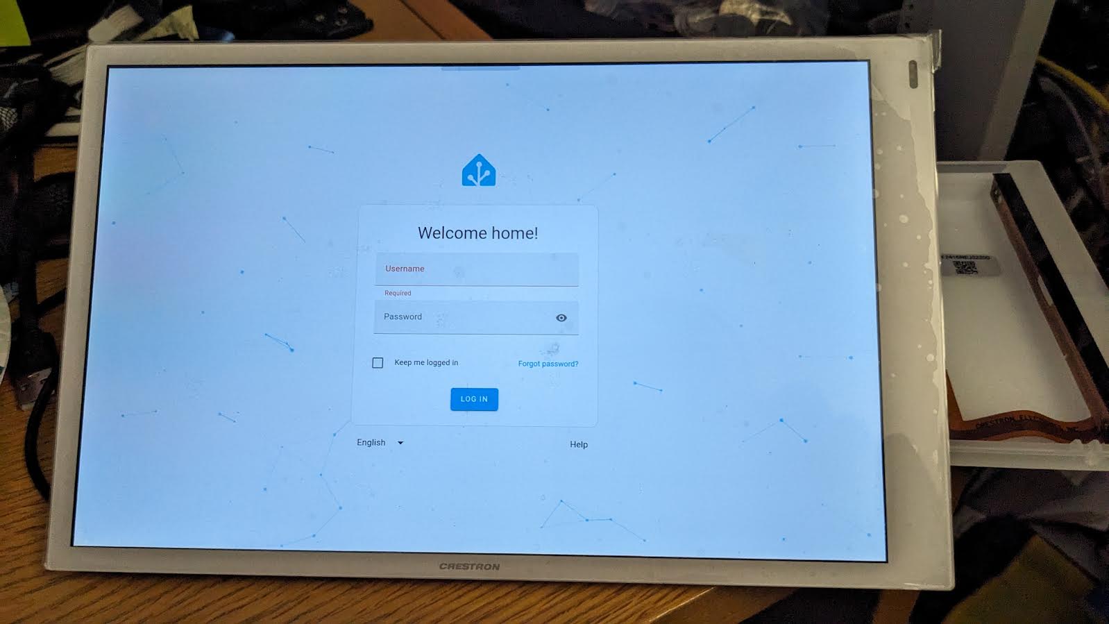

Hi all, I picked up a tsw-1060 and have a few quick questions:
I’ve logged in to HA with my main admin acct but now want to use a dedicated “wall panel” acct and can’t figure out how to force the device into letting me login with a different user.
The main issue I’ve run into is not being able to scroll the sidebar menu to get down to the user profile icon. When I try to expand and scroll the menu bar it actually scrolls the dashboard instead.
Is this an issue with out of date firmware that may fix browser behaviour and could someone PM me about the firmware?
Next question is I can’t figure out how the unit can update/set local time?
Edit: I found the date/time config :slight_smile:
Read few first messages in this topic and you will found firmware without paywall.
thanks, I did manage to find the firmware and it fixed the browser hiccups.
