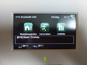

Some more settings needed to be done from the CTC i350 menu defining Smartgrid.
Then the CTC i350 was restarted and I could make some tests to see the response:
Here the Shelly ports are set to Over capacity - and it shows up on the display.
Also, the Alarm was tested and now I can get a notice to Home Assistant Companion App :alarm_clock:

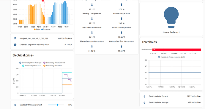

Have tried to use the Nordpool sensor!
I have had this in my mind since i got blasted by high electric bills and have been thinking on how to make my old heat pump better and better adapted to the new reality!
Any input? I’m kinda new to this :slight_smile:
And i have a CTC EcoZenith 250i with an air to water heat pump!

But Im struggling to get the threshold and classification part working, I think my math is just wrong, but here goes.
I copied Vovelivov and parts of Seffels code and got it working to show simple graphs and prices. I also noted that Nordpool sensor also has an price_percent_to_average attribute which would be good to simplify the threshold calculation.

The helpers are set and all look good on the dashboard
But something is missed and the light doesn’t come on
Update:
After a few hours of tinkering with the code I realized that the helpers input names didn’t match with the Threshold calculating section. In addition, the helper value should be “currency” and not %.
Now, Im at the part where I want to turn on the light if Electricity Price 4 Levels (24h) indicate below 4.
And im stuck again :slight_smile:
