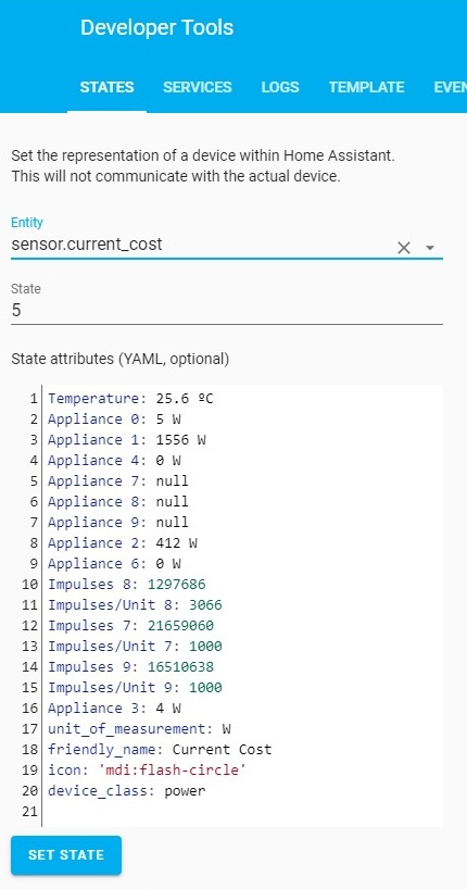

It is ages since I had this running but when I used to access the current cost tranmitter from 433Mhz RTL-SDR it was just a text line with the three values plus a total that got sent out. Any idea how I can get access to these values from within your component please? I had a look in the state topics in Developer Tools but didn’t look hopeful.

Well I had a go at working out what went where and I think I have it. First Python I have ever written so may well be wrong. I added 3 lines only to extract the individual channels, by setting the attributes:

It all seems to work nicely and the 3 channels add up to the total. If anything is wrong please let me know.
