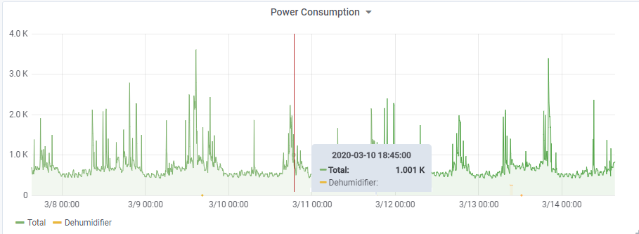

HA by default will plot the last 24h worth of data, but you can expand this by sending your data to Grafana / influxDB:
You can then also use the value to see if something is happening. For example I have a “dumb” dehumidifier that’s connected to a smart plug and power monitor.
If the dehumidifier is on but power is 0, the tank is full -> send a notification to empty the tank.
Possibilities are limitless
