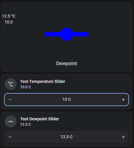

but I still get odd results
The result below is fine because dewpoint is lower than temperature
The result below is also OK because dewpoint = temperature
Again - below is OK
However the result below though is wrong as dewpoint is greater than temperature
If I make the dewpoint 2.5C then every temperature value from 10C to 24.9C is incorrect.
So, basically what am I misunderstanding / doing wrong?
