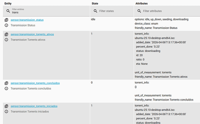

Hi there!
After reading this topic, I tried configuring my custom card following the instructions provided here, but unfortunately, nothing shows up on my dashboard.
Below is my Developer Tools configuration:

The custom card does not support translation of sensors, so you should rename the sensor entity names to English, e.g. sensor.transmission_torrents_attivos to sensor.transmission_active_torrents.
Thanks!
It solved my problem

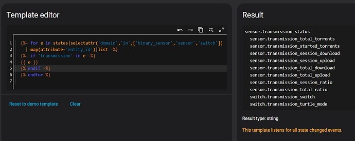

Is there any list of the sensor entity names? I would like to translate all of my sensors bud I couldn’t find the orignal english names
There are some others too, but I have them disabled.
