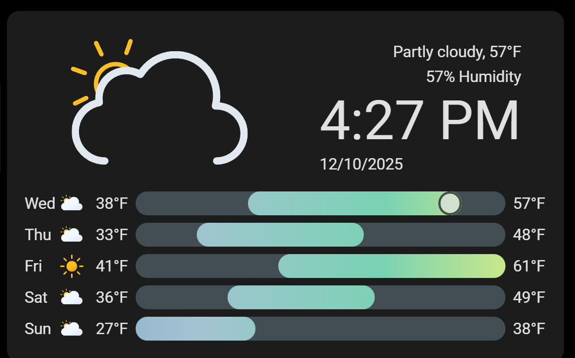

Hi there,
I am using this card together with the WallPanel integration to mimic Google Nest Hub’s idle photo collage.
The spacing between the weather icon and the information is quite big when viewing on a tablet, is there any way to get them closer together?
any idea on how to get temperature_sensor and humidity_sensor side by side ?
Here is one method
type: custom:clock-weather-card
entity: weather.forecast_home
card_mod:
  style: |
    clock-weather-card-today-left img {
     height:90px !important;
     margin-left: 100px !important;
This actually one field with a <br>

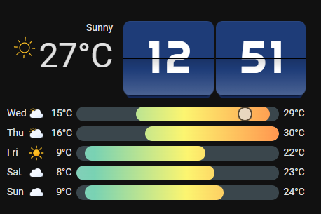

cards:
  - type: custom:layout-card
    layout_type: custom:grid-layout
    layout:
      grid-template-columns: 35%67%
      grid-template-rows: auto
      margin: 0px
      card_margin: 0px
      gap: 0px
    cards:
      - type: custom:clock-weather-card
        entity: weather.home
        weather_icon_type: line
        animated_icon: true
        hide_today_section: false
        hide_forecast_section: true
        hide_date: true
        hide_clock: true
        sun_entity: sun.sun
        temperature_sensor: sensor.outdoor_temp
        humidity_sensor: sensor.outdoor_humidity
        card_mod:
          style: |
            ha-card {
              background: none !important;
              box-shadow: none !important;
              border: none !important;
              padding-bottom: 0px !important;
            /* This hides the temperature text and other info */
            .weather__info, .weather-info, .weather-text {
              display: none !important;
            /* Force the icon to center/align properly if needed */
            .icon-container {
              width: 100% !important;
              justify-content: center !important;
      - type: custom:stack-in-card
        mode: vertical
        keep:
          background: false
          box_shadow: false
          margin: false
          outer_padding: false
          border_radius: false
        cards:
          - type: conditional
            conditions:
              - entity: sensor.flip_clock_color
                state: blue
            card:
              type: custom:pqina-flip-clock-card
              showSeconds: false
              twentyFourHourFormat: false
              hideBackground: true
              styles:
                width: 100%
                height: 40cqw
                fontSize: 25cqw
                textOffsetVertical: "-0.05em"
                font: Righteous
                textColor: rgb(255,255,255)
                frontFlapColor: rgb(30,60,120)
                rearFlapColor: rgb(20,40,90)
          - type: conditional
            conditions:
                state: orange
            card:
              showSeconds: false
              styles:
                width: 100%
                height: 40cqw
                font: Righteous
                fontSize: 25cqw
                frontFlapColor: rgb(160,90,30)
                rearFlapColor: rgb(120,70,25)
          - type: conditional
            conditions:
                state: red
            card:
              showSeconds: false
              styles:
                width: 100%
                height: 40cqw
                font: Righteous
                fontSize: 25cqw
                frontFlapColor: rgb(130,30,30)
                rearFlapColor: rgb(95,20,20)
        card_mod:
          style: |
            ha-card {
              /* Vertically center the clock relative to the icon */
              margin-top: 0px !important;
    sun_entity: sun.sun
    animated_icon: true
    forecast_rows: 5
    locale: en-IN
    hide_today_section: true
    hide_forecast_section: false
    hide_clock: true
    hide_date: true
    use_browser_time: false
    time_zone: asia/kolkata
    card_mod:
      style: |
        ha-card {
          margin-top: -40px !important; # Pull forecast closer to header
can anybody help to resize temprature and the animated icon ?
