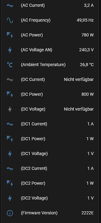

hi, i am sorry but the 1V is still there, AND 1A and 1W. So this was not the right fix.
it should be 308V, 1.66A right now.
so i changed back from dc1 … to dc. Power and Amps are ok, but DC Voltage is -0.0

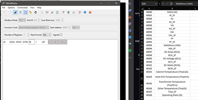

How can i see the Modbus registers? so i could try to find the Register with that value showing on the ABB-Site.?
i used qmodmaster now and i can see some registers.
i tried the following registers:
40097 DC Amps (DCA)
40098 DCA_SF
40099 DC Voltage (DCV)
40100 DCV_SF
40101 DC Watts (DCW)
40102 DCW_SF
40103 Cabinet Temperature (TmpCab)
40104 Heat Sink Temperature (TmpSnk)
40105 Transformer Temperature (TmpTrns)
40106 Other Temperature (TmpOt)
40107 Tmp_SF
40108 Operating State (St)
and get this:
the 28 is DCA 2.8A (2.844 !), the 86 must be 860W and the 267 is 26.7 Degree. No Voltage or wrong values.

i found the DC Volt Register!
It is 41124 !
I guess you must change something in init.py…?
Found out that for some inverter models, the DC Voltage is not on model 100 but on model 160 (MPPT extension). Problem is that on many inverters, model 160 starts at offset 122 from base address. For some models instead it jumps 1000, so if base address is 40000, instead of 40122 it starts at 41122.
Problem is that I don’t know how to find this offset programatically. :frowning:
well you could test if it is an abb react2-3.6tl, if so, take the 41124 for pv-voltage.
