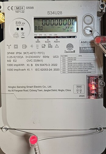

Hi, my power meter is s34u28, which iterates display over different obis codes and readouts. It shows readout of one parameter for some time, then another etc. Current obis code is also displayed, so it is clear which value is currently shown. Can this component be used to read these values? I know this meter supports different protocols, that would be easier to read but my energy provider won’t give me access/keys for that. Lower left is obis code (i want 1.8.0, and 2.8.0) bigger number is current readout for that code.
