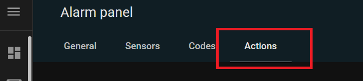

Hoping someone can help. I’ve got Alarmo configured with the relevant sensors, keypads and a siren. For some reason, I cannot get any actions or notifications to save. I’ve tried several browsers, a complete uninstall / reinstall, as well as adding the action to the JSON in the storage folder directly - still nothing is working.
Hi, can you access the control panel with http://homeassistant.local:812/alarmo ?
Do you get that page?
There you have ā€˜Actions’
And at the bottom you can add them.
Yeah that’s just it - I can see the tab and set them up but the save button simply doesn’t work. Same with notifications. I’ve tried as many fixes as I can find but no joy thus far.
Looks to be a bug:
Should be fixed if you update Alarmo.

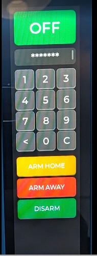

FWIW - I have developed (almost) plug and play firmware for an alarmo hardware control. I didn’t want a whole tablet etc by the front door - but wanted a control panel.
This did the trick:
Work in progress (I’ll add some enhancements) but it works!
