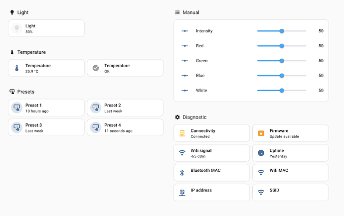

I’ve built a custom Home Assistant integration for the Aquatlantis Ori smart controller.
The Ori controller can manage lighting for aquariums or terrariums and can connect to various sensors.
With this integration, you can control supported lights directly from Home Assistant and (if available) monitor sensor readings.
:light_bulb: What It Does
  • Manual light control: Adjust overall Intensity, as well as Red, Green, Blue, and White channels individually.
  • Sensor monitoring: When supported, see readings like water temperature and device connectivity status.
  • Diagnostics: View Wi-Fi signal, firmware version, uptime, MAC/IP address, SSID, and more.

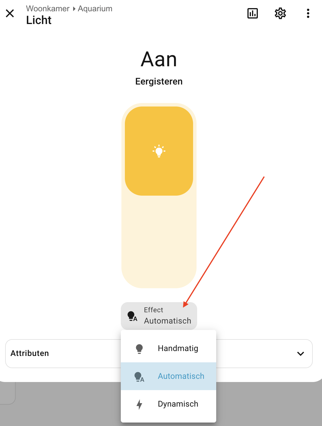

I’m still using the integration. It works really nice. I have only one question which I just posted on github: ’ Switch between manual and auto’. It would really be nice if it’s possible to switch between the manual mode and the auto mode. My aquarium normally runs on its own program in the auto-mode. But once in a while (mainly in the weekends) it’s nice to have the lights on a little longer. I do this with the manual mode and the presets.
I don´t know if you are still working on the project, but it would really be nice if this is possible.
Hi @eleemr, let me answer that question here.
It’s actually quite easy to switch between these modes, either manually in the UI or with an automation. Let me share both ways.
Manual:
In the more info dialog of the light, there is an effect button. This button allows you to switch manually between the 3 effects (the 3rd is the lightning effect)
Automation:
action: light.turn_on
  entity_id: light.aquarium_licht
  effect: automatic
The effect can be either automatic, manual, or dynamic.

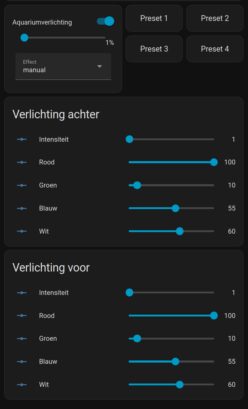

I hadn’t seen that yet. Just took a look and it works good and very easily. Now I just need to figure out how to link two of them together in HA. I’ve got two rgbw lights above my aquarium, so I also have two ori controllers.
The dutch is no problem. I’m also dutch.
You could try to create a light group helper and put both lights in there. If that works, that would be the easiest solution to control both.
Otherwise, you might want to only control 1 light and use an automation to keep the other light in sync.
Let me know what works, I’m curious.
Sorry for the slightly delayed response, but it’s been a bit busy the past few weeks. I only got around to trying it out today.
The idea with the Group Helper was indeed a good solution. I first grouped the lighting. That worked, but I always had to tap the card first before I could select the effect. That was solved by using the Light Entity Card via HACS.
After that, I also grouped the preset buttons. That worked perfectly right away. So the same can be done for all the other buttons within this integration as well. Now I just need to come up with something to group the Reds, Greens, Blues and Whites. In Home Assistant, that is a number entity. As far as I have been able to find, there is no Group Helper for that.
Happy to hear that this seems to work.
Do you think the RGBW and intensity sliders are useful? I copied them from the ORI app, but they aren’t really the HA way. As we’re able to control the light color directly on the light entity eg:
  entity_id: light.aquarium_light
  brightness_pct: 80
  rgbw_color: [0, 0, 0, 255]  # Pure white
Also the values become unavailable when the automatic schedule is active.
(This would also allow to make a lot more presets in HA, eg. with a template button).
I do find the sliders quite convenient. Now I can manually adjust the individual colors from Home Assistant. You can also create an unlimited number of presets that way. Of course, for an aquarium that’s not really necessary, because you want a stable situation there. I mainly use the manual setting now to occasionally keep the light on a bit longer in the evening. And that works very nicely via Home Assistant.
Now I just need to find the time to link the color sliders of the two lamps together so I have one set of sliders to control both lights at once.
